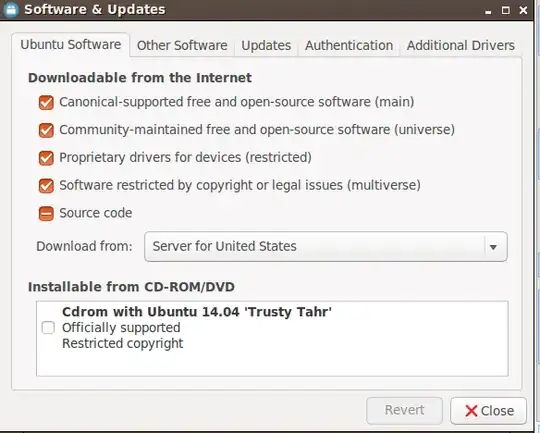

I compared your sources.list with one from a trusty machine of ours. Other than the country of origin of the servers, the big difference I saw was that your .list still contains the cdrom file. I remember removing this to solve some kind of problem, perhaps it was this?
Anyway, it is easy to test. Open "software & updates" and uncheck the last box. When you click Close, it will reload the sources, and tell you if it worked or not.
