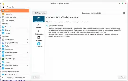

I need some help. My backup aren't working. I checked my settings and it saybup is not installed on my computer.
Update

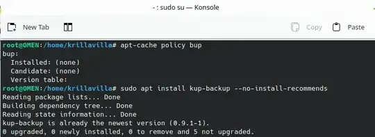

When I attempt to install bup package on commandline, I get an error message:
Reading package lists... Done
Building dependency tree... Done
Package bup is not available, but is referred to by another package.
This may mean that the package is missing, has been obsoleted, or
is only available from another source
E: Package 'bup' has no installation candidate
Also, I have tried the aptitude command:
sudo aptitude install bup
No candidate version found for bup
Unable to apply some actions, aborting
I wonder if these are package that need to be install on computer in order for me to install bup

Edit since bup does not install for you.
bup installs for me on Ubuntu MATE 22.04. It must be that either your sources are out of date, or you are using an outdated server hosting the repositories. Follow this question to restore default sources.
Once done, you can install bup with
sudo apt install bup
How I got to know the package name - I searched on packages.ubuntu.com.
