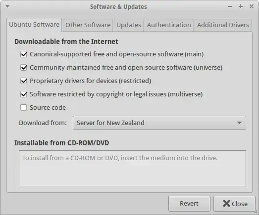

Looks like your sources file is corrupted and there are broken packages. Remove the corrupted source file by pressing Ctrl + Alt + T to open a terminal, and type in:
sudo rm /etc/apt/sources.list
Then, type in
sudo software-properties-gtk
This will open software-properties-gtk and a new sources.list will be created automatically.
Then change the server to US or to any other server of your choice. You must enable repositories from the new dialog in order to create new sources.list.
Tick all the boxes then click on Revert then click close.
How do I restore the default repositories?
Step 2 Open up a Terminal and type in
sudo apt-get remove --purge google-chrome-stable
Then run
sudo apt-get update && sudo apt-get dist-upgrade -y
Then install Chrome.
