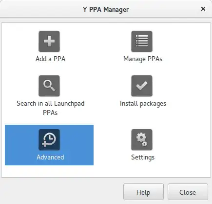

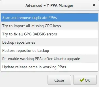

You can remove duplicates with Y PPA Manager:
sudo add-apt-repository ppa:webupd8team/y-ppa-manager
sudo apt-get update
sudo apt-get install y-ppa-manager
Run Y PPA Manager
Select Advanced
Select Scan and remove duplicate PPAs
When this is complete, then start an update:
sudo apt-get update
