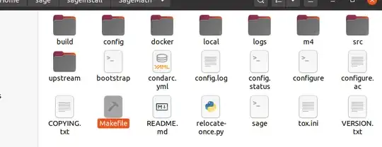

The sage folder contains the files shown in the image, if there is lacking something I may not undestand while downloading the source code, then please guide
This is the sage root directory where I have put everything
