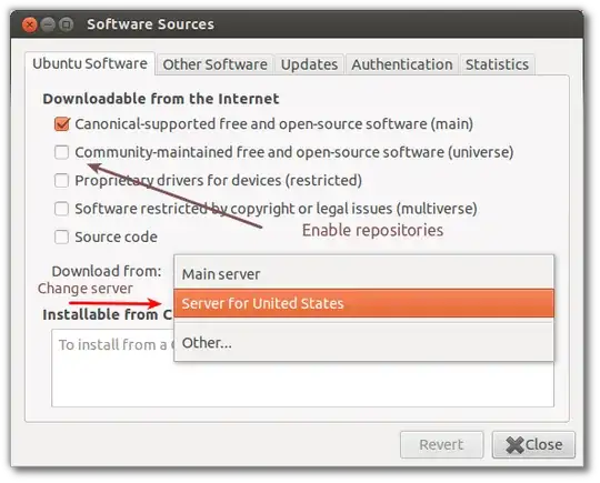

I found what was wrong in another post... this one: How do I restore the default repositories?
It seems some code I used from another forum just ended up messing my repositories I guess? Sorry I asked for help when I just needed to do more research :P
So what I did was:
  • run the following code: sudo rm /etc/apt/sources.list
  • then: sudo -i software-properties-gtk
Go to software-properties-gtk (run it in the console) and reset the repository to the one closest to me (geographically):
Should look like this
and then just reset the update configs to whatever suits you I guess, I put all to automatically update daily.
Then I just ran sudo apt-get intall r-base in and it worked!
