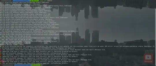

UPDATE thank to all who answered me. at this time i still trying install photoshop. so i did what me recommended. I install necessery utilites - wine, winetricks during installation all works well https://i.sstatic.net/EzcVn.jpg but then i got this
"it looks like wine32 is missing, you should install it. as root, please execute "apt-get install wine32""
and i did it https://i.sstatic.net/inbmO.jpg all the same an error occured and now problem with broken packages https://i.sstatic.net/EQD5z.jpg
Maybe someone explain me how can i this unfortunate photoshop install? thank you!
At time of writing WineHQ repository for Ubuntu 20.04 LTS works normally.
So your problem is caused by broken mirror at http://mirror.vorboss.net/ubuntu-archive. You have to switch from it to Main Server or other server by using Software & Updates (software-properties-gtk) for this purpose.
Then fix other broken repositories and keys by
curl -sS https://dl.yarnpkg.com/debian/pubkey.gpg | sudo apt-key add -
sudo apt-key adv --keyserver keyserver.ubuntu.com --recv-keys 23E7166788B63E1E
sudo add-apt-repository -r ppa:andrew-crew-kuznetsov/xneur-stable sudo add-apt-repository -r ppa:atareao/flameshot sudo add-apt-repository -r ppa:chris-lea/node.js
And finally run normal package lists update and package upgrade procedures by using below commands:
sudo apt-get update
sudo apt-get install -f
sudo dpkg --configure -a
sudo apt-get dist-upgrade
