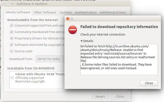

I had a problem as follows:
W:Failed to fetch http://in.archive.ubuntu.com/ubuntu/dists/trusty/Release  Unable to find expected entry 'restricted/source/Sources' in Release file (Wrong sources.list entry or malformed file)
, E:Some index files failed to download. They have been ignored, or old ones used instead.

and I found enter image description here
Please tell me how to solve it ?

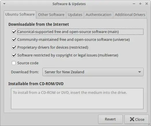

Update after Neil's answer:
Following problem occurs
You have to remove the corrupted source file and add it back with software-properties-gtk Do this by pressing pressing Ctrl+Alt +T
sudo rm -f /etc/apt/*
sudo rm -f /etc/apt/sources.list.d/*
sudo rm -f /etc/apt/apt.conf.d/*
Then run
sudo software-properties-gtk
Tick the boxes, change the server to US or to any other server of your choice, then click close.

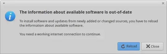

Then click reload.
Wait for it to finish then run:
sudo apt-get update
