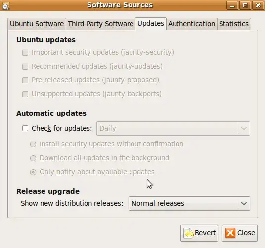

GUI Method

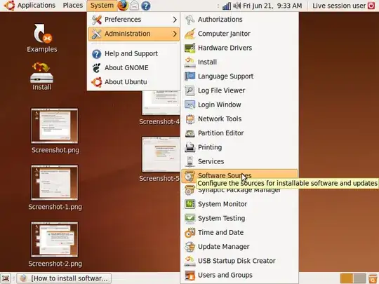

Well, actually we will do this without using any terminal. Not even once. Just GUI, I promise ;-)

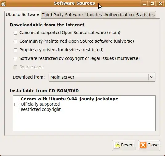

First, open Software Sources (or Software & Updates in newer versions). It does not matter how old your Ubuntu is, there is certainly something like this. For Ubuntu 9.04 (Jaunty Jackalope), look at next image to see where it's located:
Open Software Sources
After Software Sources (or Software & Updates) is open, go in Ubuntu Software and Updates tabs and unselect everything like in next pictures. You don't need these things anymore since your Ubuntu version is End of Life:
Ubuntu Software tab

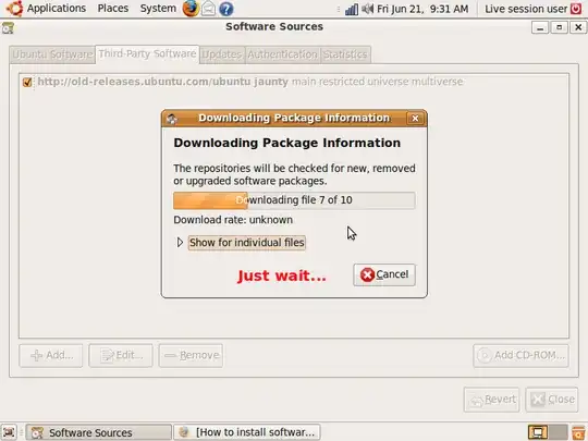

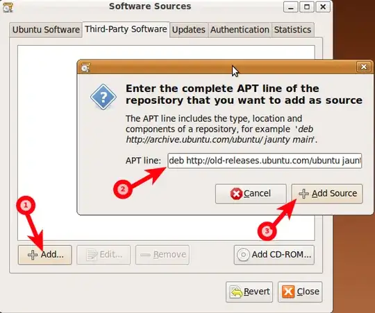

Without closing Software Sources (or Software & Updates), go in Third-Party Software (for newest releases, this tab is named Other Software) tab and add a new apt repository. Insert exactly next line when you are asked:
deb http://old-releases.ubuntu.com/ubuntu jaunty main restricted universe multiverse
If your version of Ubuntu is not 9.04, replace in the above line jaunty with your Ubuntu codename (for example, if you have Ubuntu 9.10, replace it with karmic and so on):
Third-Party Software tab

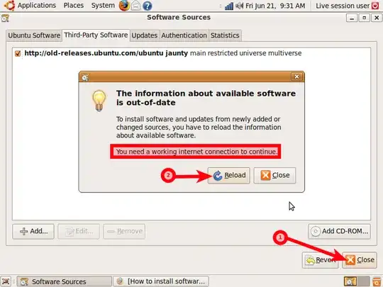

Now, when you will close Software Sources (or Software & Updates), you will be asked to reload the information about available software. Just be sure that you have a working internet connection:
Reload available software
Downloading available software

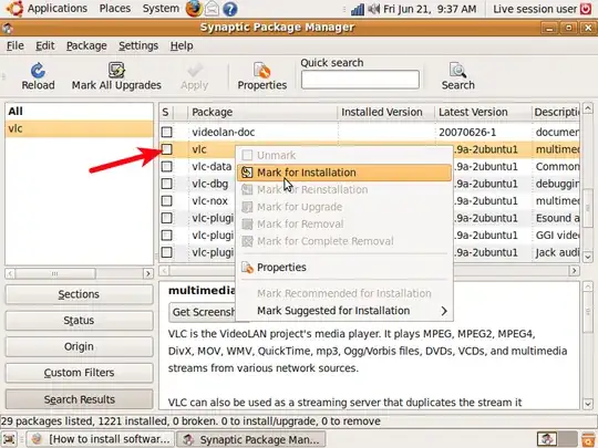

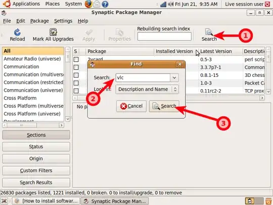

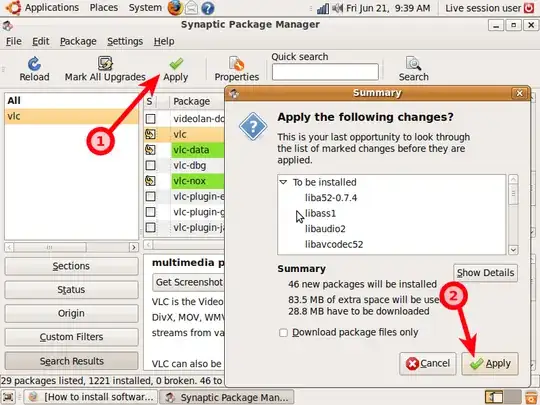

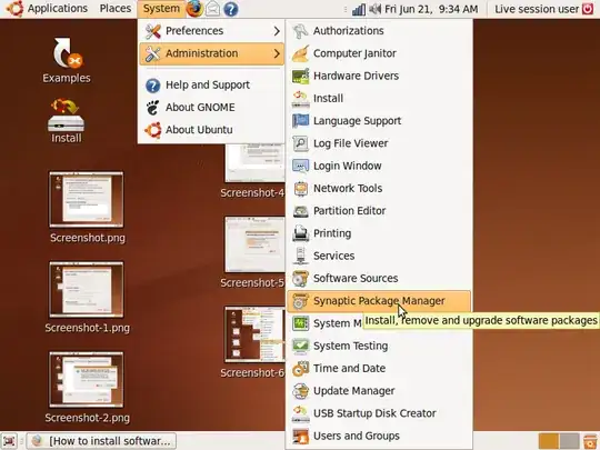

And now, you are free to download almost whatever you want. For 9.04, you can use Synaptic Package Manager. For newest releases, there is Ubuntu Software Center.

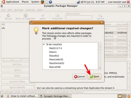

For example, to install VLC in Ubuntu 9.04 using Synaptic Package Manager, follow the instructions in the following pictures:
Open Synaptic Package Manager
Search VLC in SPM
Mark VLC
Mark additional VLC
Apply VLC
Download VLC
Open VLC

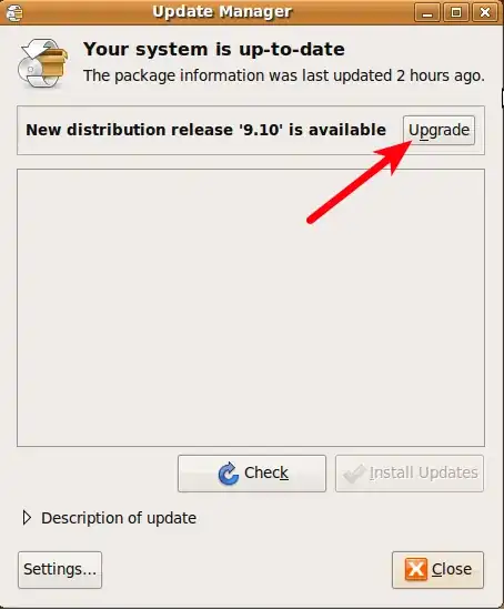

If you want to Update your Ubuntu to a new release, just go to System > Update Manager:
Update Manager
Upgrade
I tested this method from a live session of Ubuntu 9.04 (Jaunty Jackalope) and as you can see from these pictures it worked. If you are on an installed session of Ubuntu, you will be asked sometimes for root or admin password. Just insert your personal user password when you are asked.
