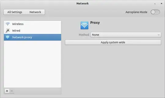

For some reason, you have proxy settings configured. Assuming you don't need them, open System Settings, go to the Network section, set Proxy settings to None and click Apply system wide:
