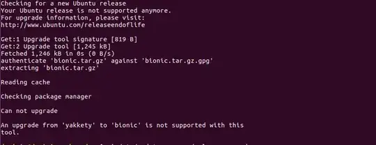

I am unable to upgrade to 18.04 with the following error message
An upgrade from 'yakkety' to 'bionic' is not supported with this tool.
Can not upgrade
How do I solve this?

I did this:
  1. backup the entire disk using Clonezilla just in case
  2. backup /etc/apt/sources.list
  3. edit it as prompted here: How to install software or upgrade from an old unsupported release?
  4. that page also states to:
    sudo apt-get update && sudo apt-get dist-upgrade
    but I did:
    sudo apt-get update
    sudo apt-get upgrade
  5. I restored sources.list and replaced yaketty with bionic
  6. I tried to update with the GUI tool but at this point something was failing due to the fact that my /etc/fstab didn“t include for some unknown reason an entry for mounting /. I corrected it and rebooted
  7. After that the upgrade tool ran smoothly

Ubuntu 16.04 LTS will release-ugprade direct to 18.04 LTS (ie. LTS to next LTS).
Ubuntu 16.10 release-upgraded to Ubuntu 17.04, then to Ubuntu 17.10 (both now EOL) and then to 18.04 LTS. ie. the only tested and supported non-LTS upgrade-path is via every release (not skipping releases). If you want to release-upgrade less often, use a LTS or long-term-support release next time.
The only supported way is via install; I would use 'something-else' & use existing partitions without format. It'll take note of your added packages, wipe system directories then install, add-back your additional programs (if from Ubuntu repos) without touching user data. It's what I'd do.
Please note backup any data before you do the re-install. Better safe than sorry
