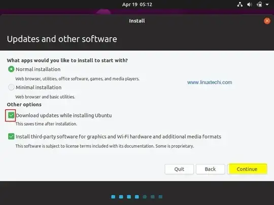

In case if you do not have a PC and iso with supported ubuntu version, than install the current version unchecking Download updates while installing Ubuntu
Then you could download 20.04, write your installation medium with it and reinstall Ubuntu using it.
It is better to reinstall it, than upgrade from unsupported release.
