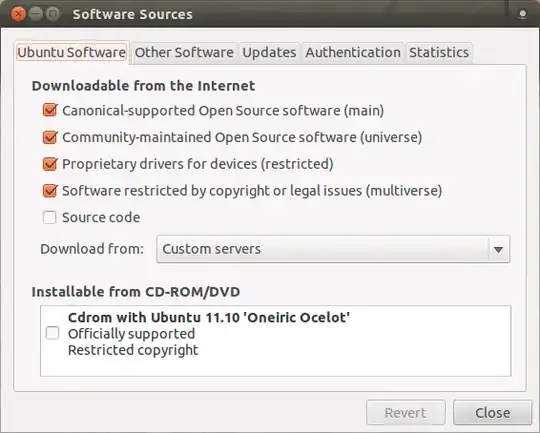

You need to ensure your software sources are enabled for Restricted Extras and Multiverse.
Open the Software Centre from Unity then select Edit -> Software Sources.
In the dialogue box that opens ensure you have the following selected;
Software Sources
Once this is done close the box and search for VLC in the Software Centre, you will then be able to install it.
