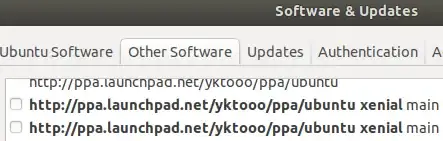

Try launch "Software & update" utility, and disable these PPA`s on tab "Other"
screenshot
