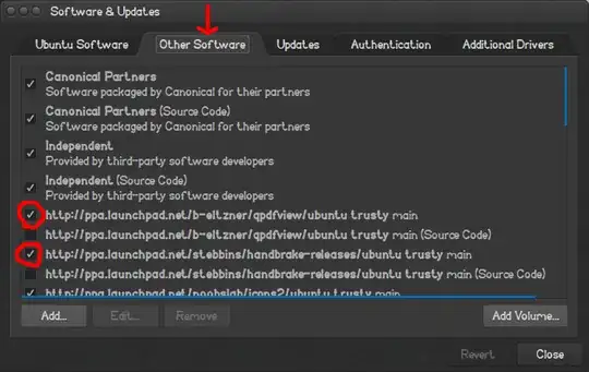

As out of my comments the solution that worked for you is to disable ppas that you have added before an upgrade to newer version.
As stated if you're trying to upgrade to 14.04 some of the packages and ppas can be no longer available in 14.04 they have been stopped in developing or replaced with others that 14.04 requires. The best is to disable all those ppas that you have added to Software & Updates in System Settings you can find that for example:
Unmark ppas corresponding to Launchpad and then run do-release-upgrade -c -d there you'll be listed with possible actions to upgrade. And if you need some of those packages from those ppas that you have disabled you can check it in Launchpad for example this ppa as you can see its developing has been stopped since 12.10 version of Ubuntu though you can still run it in Ubuntu 14.04 you just have to find another ppa with current package like this one or install it manually from .deb file.
