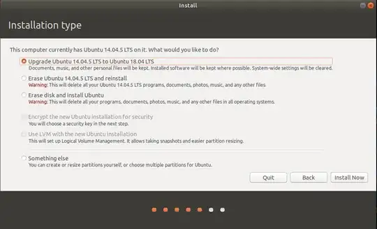

  2. You are offered options when you do the install. Here is what the options screen looks like on a preliminary version of 18.04:
Note that as @user68186 mentioned in a comment, there is an option to "upgrade" while keeping your files and your programs "where possible". I personally haven't used this option.
