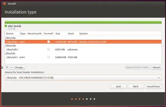

On the next screen, you'll be presented with something like this:
Installation type gparted menu screen
From your description you should only have one partition, so select that one and then click the Change button.

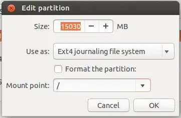

Change the Use as: option to be the same type as your partition. So in my example this is ext4. And select the mount point to be /. Make sure the Format the partition: option is not ticked - this is how you will protect your /home directories/files/settings. You should have something like this:
Click OK and then click Install Now. Then follow the rest of the install steps as usual.
