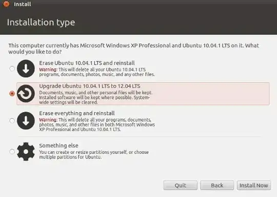

To upgrade to 14.04, download it's .iso file, burn it onto a flash drive. You will get an option to upgrade during the installation process, similar to the one in the image. You won't loose your data stored in your /home directory.
Now if you are on a server and cannot do it like this,you can do it from the command line, but it will require some effort. You can only upgrade to the next distro. So you need to upgrade to the next version, which is 13.04, and so on ultil you get to your LTS. Canonical may have removed the sources for 13.04, but digitalOcean still provides the sources for old releases here.
So update your sources.list with that from digitalocean and then upgrade sudo apt-get update sudo do-release-update
