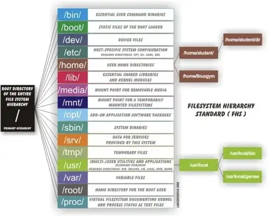

Tree
This picture is worth 1,000 words. The "problem" is that there is no standard used by all distros, and thus each distro makes (minor) variations. For example, while Debian and Ubuntu use /usr/local , other distros use /opt (for installation of packages compiled from source or outside the package management system [apt on ubuntu] ).
BUT - that is the old standard. The new standard is 3.0, see
https://refspecs.linuxfoundation.org/FHS_3.0/fhs-3.0.html
Some of the highlights:
The source is now valid DocBook XML, with the appropriate tool changes.
New directories, including /run and /sys.
Removal of older compatibility directories, such as /usr/X11R6.
Many typos fixed, and clarifications made to ambiguous sections.
Various distros are in various stages in implementing the new standard.
