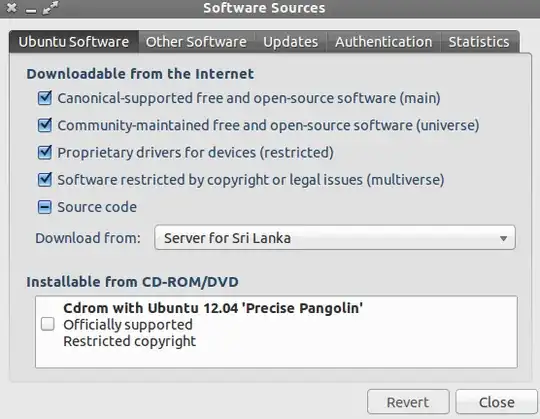

Enter this command on terminal:
sudo software-properties-gtk

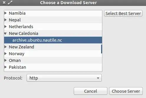

Software Sources window will come up. Under the "Ubuntu Software" tab, choose "Other.." inside "Download From" drop down menu.
Then select this as your download server :
New Caledonia
achive.ubuntu.nautile.nc
Reload the package index (or sudo apt-get update), and thing should work fine. Most servers around the world are removing packages of old Ubuntu releases.
