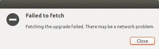

As I understand it, in order to upgrade from 14.04 to 16.04 one must upgrade to 14.10. At this time it appears 14.10 is not supported. From the command line do-release-upgrade -d produces
WARNING:root:file 'utopic.tar.gz.gpg' missing
Failed to fetch
Fetching the upgrade failed. There may be a network problem.
(there is no problem with my network)

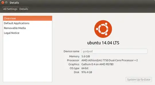

By running the normal upgrade commands in 14.04 ( sudo apt-get update, sudo apt-get upgrade, sudo apt-get dist-upgrade, sudo update-manager -d) -
Canonical responds with the following -

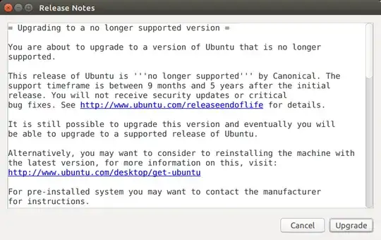

Selecting "Upgrade" gives -
By doing the following I was able to upgrade from 14.04 to 14.10
  1. Change all instances of http://us.archive.ubuntu.com/ubuntu/ in /etc/apt/sources.list to http://old-releases.ubuntu.com/ubuntu/
  2. Run the normal commands: sudo apt-get update, sudo apt-get upgrade, sudo apt-get dist-upgrade, sudo update-manager -d
  3. Then upgrade from 14.10 to 15.10 and then to 16.04
