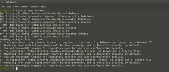

Trying to update my ubuntu 19-04 disco apt sources.list and I have this error message since a few days:
sudo apt-get update
apparently all main mirrors for ubuntu disco are gone from http://archive.ubuntu.com/ubuntu/dists/ even google's cache still references the urls I have in my apt sources.list
google search
but I get the same 404 not found from the browser (obviously) so does anyone experienced the same issue recently? I can't imagine that the urls for main repositories for ubuntu 19-04 disco were just updated...?

thanks @Doug Smythies for pointing that ubuntu 19-04 disco is now EOL (End Of Life) so when this happens, one should upgrade to the latest "10" version with command:
sudo do-release-upgrade
https://www.omgubuntu.co.uk/2020/01/ubuntu-19-04-end-of-life
