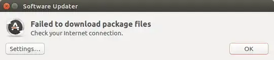

I have had a old partition of Ubuntu running 17.04 that I haven't booted to in ages. I finally booted back into it the other day and wanted to know how do I upgrade? The software updater doesn't work anymore. I assume because the software sources are taken down. How do I update the sources? And which one should I update them to to have a safe upgrade? Perhaps I could set my sources to 18.04 first and do that upgrade?
Error message in software updater
