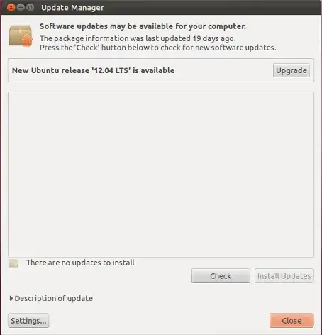

To update from an older version (very old in this case) than the previous version to the current version is highly not recommended. You are better off downloading the new release, doing a backup and then installing the new release.
If you are using Ubuntu 10.04 and REALLY REALLY want to update from that version up to the latest version then keep reading, if you are using Ubuntu 10.10 and also want to update from that version up to the latest version go to the second part. I should warn at least users from 10.10 that this involves downloading more than 2GB of data and will take you around a whole day. And even at the end it might be slower, give you errors, your connection will drop at some point or the computer will go crazy. This means that I do not give a guarantee that it will work flawlessly on every PC. So really think about it if you want to upgrade this way. I recommend reading this link: How do I upgrade to a newer version of Ubuntu?
Here is an image that shows what 10.04 users should see after 12.04 was released:
UPDATE - if you are reading this after 12.04 came out, there should be an option in the Update Manager in 10.04 that says to upgrade from 10.04 to 12.04. This is the way to go since 12.04 came out.
For historical reasons I will leave the information below for users that wanted to know how to do it before 12.04 came out but if you are still in 10.04 please read here: How do I upgrade to a newer version of Ubuntu? since fossfreedom created a very good and complete answer about upgrading from 10.04 to 12.04.

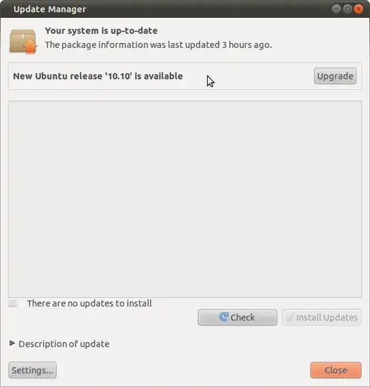

When the Update manager opens and it does NOT show the "New Ubuntu Release Available" message in the upper part do the following steps:
2- Click on the SETTINGS button in the Update Manager on the lower left part of it. After the Software Sources Windows opens it should have you in the Update Tab where you will change the option Release Upgrade at the bottom. Change it from the one that it has to Normal Releases then close. What you did here was tell Ubuntu not to check for LTS versions but to check for normal version instead. Normal versions are the ones that come out every 6 months. LTS come out every 2 years. For example 8.04, 10.04, 12.04..
2.1 Open The Update Manager again following the Steps in 1a or 1b.
enter image description here 2.2. Click on the UPGRADE button that should appear there in the upper part. After finishing the upgrade reboot the PC and you should be in 10.10. Test it a little and then if you are 100% sure to go to 11.04 do the following:

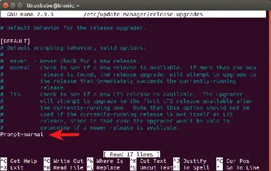

Next, edit a configuration file using nano or your preferred command line text editor.
sudo nano /etc/update-manager/release-upgrades
At the bottom of this file, change the value of Prompt from lts to normal.
Prompt=normal

This question is rather old (Ubuntu 10.04 to 11.04 was long ago) and what I describe in this answer would not have worked in that upgrade cycle; but things have changed since then. Ubuntu 10.10 & 11.04 were non-LTS releases with 15 months of supported life; non-LTS support now only comes with 9 months for a start...
If you're on a LTS release (eg. Ubuntu 22.04 LTS currently), and have the prompt=normal option (not LTS), you can currently release-upgrade from 22.04 LTS to the latest non-LTS in the next development cycle, currently Ubuntu 23.10.
When Ubuntu 22.10 was released, the release-upgrade from 22.04 would go to 22.10, but when 22.10 reached EOL, the path changed to 23.04 until it reached EOL then switched to 23.10 where it is currently. After release of Ubuntu 24.04.1 the current release-upgrade path from 22.04 LTS will finally point to the next LTS release which is Ubuntu 24.04 LTS.
These upgrade paths get CI testing (Continuous Integration) testing on Ubuntu infrastructure; but very little user QA testing, so not using this upgrade path maybe a wise decision (ie. 22.04 LTS to 22.10 got a lot of QA testing by people + CI testing... where 22.04 to 23.04 or 22.04 to 23.10 gets the same CI but almost no QA by users on their computers). Either way there is a valid release-upgrade path that allows skipping a release to a non-LTS for current releases of Ubuntu.
Synopsis.
An LTS user can currently release-upgrade to the oldest supported non-LTS release in the next two year development cycle. As I write this, that means a Ubuntu 22.04 LTS can release-upgrade to Ubuntu 23.10.
If you're using a non-LTS release however, this will not help you sorry.
