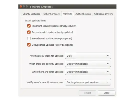

Using the GUI, launch Software Updater and click on the settings button.
Click on the update tab, it should look like this enter image description here
Make sure the option on the bottom is selected as seen in the picture (long-term support version). Apply changes and check for upgrades again.
