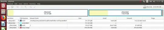

3) Have you generated a screenshot of gparted to show the layout of your partitions and added it to your question with edit? enter image description here

Solution following the steps provided by @heynnema:
  1. backup an image of /dev/sda. DONE.
  2. Boot ubuntu from USB and gparted from that ubuntu system.
  3. "resize sda1 by moving the right side of the partition towards the left, by the size that you wish to add to sda6". DONE.
  4. "carefully resize the left side of sda2 extended partition all the way left". Precondition: unmount /dev/sda6 partition. After that its successful. DONE.
  5. "carefully move the sda6 partition all the way left". DONE. However, it show a notification as attached. I take a deep breath and click OK. DONE. notification
  6. "click the Apply icon" in the top. It take some time to apply the changes. After I come back from Lunch it looks finished :) before apply after applying
  7. Shutdown the ubuntu from the USB. Start the Machine and boot from hard-drive.
Fortunately there is no problem occur during boot-up. So, taking the risk is payed off.
Thanks a lot @heynnema for your great assistance.
