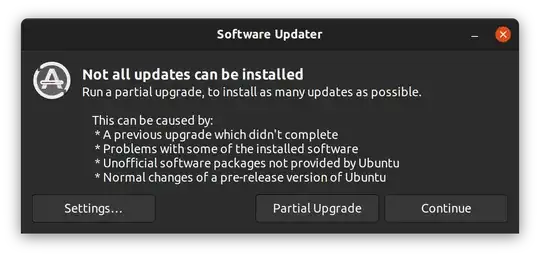

  1. When I start the GUI software updater I get the following window, which I am somewhat reluctant to click 'Partial upgrade', because I do not want to blindly mess up my system:
