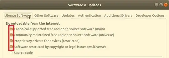

  1. Run sudo software-properties-gtk
  2. Under 'Ubuntu Software' tab select/tick the first 4 options- main, universe, restricted, multiverse
Softwares & Updates
  1. Click 'Close'
  2. Click 'Reload'
Now, try your install command again.
