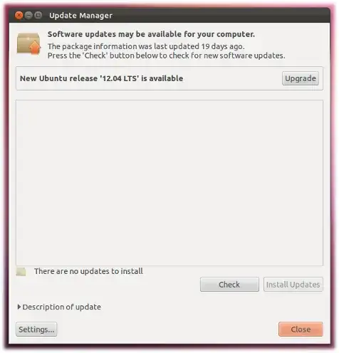

  3. If there are any updates to install, use the Install Updates button to install them, and press Check again after that is complete.
  4. A message will appear informing you of the availability of the new release.

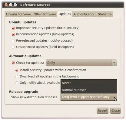

For 10.04LTS/12.04LTS users you need to check the "Release upgrade - Show new distribution releases" drop-down to make sure "Long term support releases only" is selected, and change it if otherwise. See the Trouble-shooting section below for more details. Please see the trouble-shooting section for the special case for LTS users between 12.04/14.04 and the release 12.04.1/14.04.1
update-manager-upgrade
  1. Click Upgrade.
Follow the on-screen instructions.

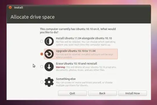

Upgrading by using the CD or USB image
If you are using 10.04 LTS/12.04 LTS or 11.10/13.10 and you either insert the live CD or boot from the live CD to start installing it will give a option of upgrading to 12.04/14.04. It will automatically detect installed applications and install the updated version of your applications also.

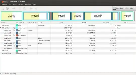

My method, based on half a decade's experience of painful ubuntu upgrades, is different. I'm not trolling, just sharing the methods I use.
Of course you can't afford to lose all your data, so yes, back it up. But I start from an earlier question: can you afford to not be able to access your data because everything's broken? If not, then this method might be for you. You need a little free disk space.
I keep 2 operating system primary partitions (and a separate one for data, swap...). So, for example, I have Natty at /dev/sda1, and have been running Precise Beta in /dev/sda2.
Then I choose an option: upgrade or clean install. As Linux Mint point out, an upgrade never feels like a clean install, but sometimes you want that.
For a clean install you just plug in your new USB stick and tell it to install in /dev/sda2, pointing /home to your existing home partition.
To do an upgrade I image sda2 from sda1. There are many ways to do this, fsarchiver is good, or plain ol' cp or tar will do the trick. Once I've made identical copies of all files in the spare partition, I mount it and edit /etc/fstab to update the UUIDs for the new partition or it will get confused. Then I run grub-update and next time I reboot grub offers me 2 choices. I check that I can boot either. Then do your upgrade as above.
Further warning: new desktop versions tend to mangle old desktop config files. So you can end up with the old and new systems being broken. If you have the disk space, cp -ar /home/{youruser,newname} and point the new user's HOME to this new path in /etc/passwd.
Having 2 OS partitions gives me a fallback; If something in the new system (might be a driver, a bug, a missing app...) is affecting productivity, I can at least go back to where I was. It's obviously not for the feint-hearted or noob.

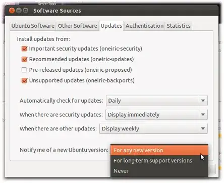

The official ubuntu.com page has information:
You can easily upgrade over the network with the following procedure.

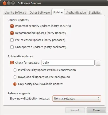

  1. Launch the software center.
  2. Go to Edit -> Software Sources
  3. Select the sub menu Updates from the Software Sources application:
    software-sources
  4. Change the Release Update drop down to "Normal Releases" and close the application

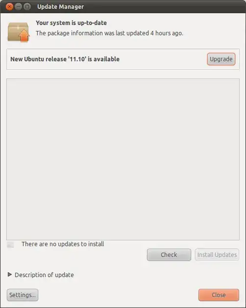

  5. Launch the update manager.
  6. Click the Check button to check for new updates.
  7. If there are any updates to install, use the Install Updates button to install them, and press Check again after that is complete.
  8. A message will appear informing you of the availability of the new release.
  9. Click Upgrade.

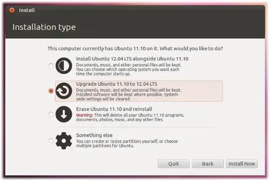

From 11.04 onwards,when you boot the livecd and start installing it will give a option of upgrading to 11.04. it will automatically detect installed apps and install the updated version of your apps also. Assuming you're not dual booting.
live CD : Allocate drive space

Securely Upgrade 13.04 to 13.10 Using Command Prompt
Since 13.10 has been released, many would like to know how to upgrade the previous version (13.04) of Ubuntu to Latest version 13.10. Before upgrading to 13.10 it would be good to know the changes/support/compatibility.
So I suggestion to follow these steps in order to upgrade 13.10 effectively.
  • First open Software Sources and be sure that possible changes has been set.
    • Run this command in terminal:
      sudo software-properties-gtk
      When Software Sources Window opens do these changes:
    • Under Ubuntu Software tab tick all four Check Boxes.
    • Under Updates tab tick first two Check Boxes, and set value of Notify me of a new ubuntu release to For any new version
    • Under Other Software tab tick first four Check Boxes and untick/remove remaining if someone don't like to upgrade the third party software that he/she installed by adding repositories. (recommend to remove).
  • Close the window and execute following command to update repository:
    sudo apt-get update
  • Now it's time to check the compatibility/changes/support etc.. by do-release-upgrade -d option. To get more info run: man do-release-upgrade Type this command in terminal:
    It will download Upgrade Tool Signature of around 1 MB named something saucy.tar.gz. After that it will prompt password to extract it and finally check/fetch the packages in repository and after some time it will show the complete description of packages going to be upgraded, size downloaded and installed etc.. after pressing Enter.
    13.04 can be upgraded at the same time to 13.10, by press Y when prompt to install upgrades.
It is the easiest and most safest way to upgrade to 13.10. Upgrades can be always be installed later if aborted before, by executing:
sudo apt-get upgrade
or
sudo apt-get dist-upgrade
To know more about dist-upgrade type : man apt-get dist-upgrade

For the recent Ubuntu releases, e.g. 12.04 onwards, once a new Ubuntu release is available, you will be prompted to upgrade. Once you click "upgrade" in the prompt, follow the instruction on the screen, you will be upgraded to the new release.
If there is no prompt, you can check the following. Type the following command in terminal:
update-manager
The update manager window will appear and check for the updates. Install all the updates detected.
Click "Setting..." In the update manager, and click "update" tab of the window. For the question "Notify me of a new Ubuntu version", if you choose "For Long term supports version", the new Ubuntu upgrade may not be prompted as the new version of Ubuntu may not be the "Long Term Supports" one. If you choose "For any new version", the new Ubuntu upgrade prompt will most likely appear.
In https://wiki.ubuntu.com/Releases you will find which version is Long-term supports (LTS) and which is not. Also, you will see each version's release date and life time. Quite useful information.
When the new Ubuntu version released, usually the upgrade prompt would not be appeared immediately. For when the new Ubuntu upgrade prompt will be available for your current Ubuntu version, you can check the Release Notes of the new version in https://wiki.ubuntu.com/Releases
