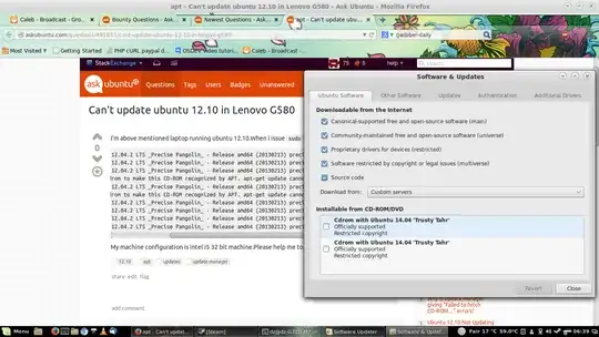

open software & update manager
uncheck the CD/DVD updates installation enter image description here
