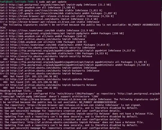

I am trying to update the packages on my system but I get this errors: updateError

Source: @guiverc
Ubuntu 21.10 (along with all flavors) is End-of-Life and thus unsupported on this site, and many other Ubuntu sites, unless your question is specific to moving to a supported release of Ubuntu. Upgrade Guide
The errors related to the EOL status... The warnings notices were offered to users prior to EOL(eg.https://fridge.ubuntu.com/2022/07/19/ubuntu-21-10-impish...) & posted online ~6 weeks prior to EOL but after EOL the repositories are dropped from mirrors and the main archive it moved as per EOLUpgrades link provided. EOLUpgrades
Now do sudo do-release-upgrade to fix this issue.
