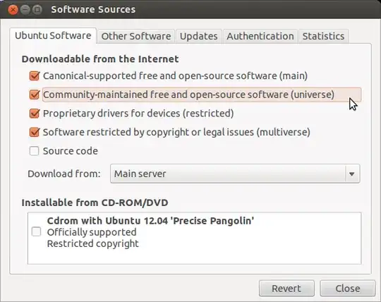

First, open software center. Click on 'edit' and then 'software sources' to open the software sources window. Once that is open, check the box that says, "Community-maintained free and open-source software (universe)."
Now, all the universe packages should show up in software center just like all the other ones.

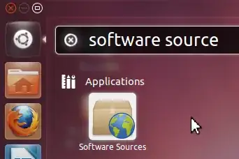

Open dash and type Software sources
type <code>software sources</code> in Dash
then open software sources and click on the the universe repository .
select "Community maintained Open Source Software (universe)"
Close and reload cache
reload cache
