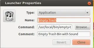

If you have a trash bin on the desktop or elsewhere, it will continue to work properly and it will still show the full and empty trash bin icons. If you do not want to hear the trash-empty sound then you can right-click on your regular trash bin icon and empty the trash in the usual way. To empty the trash and hear your chosen sound click on the launcher made for that purpose. My trash-empty sound is that of breaking glass. You can choose whatever sound file you like, or make your own.
If you click on "Yes" in the zenity confirmation dialogue, then all the trash in all locations, including partitions and USB drives, will be emptied.
You can make an "Empty Trash" launcher and put it on your desktop to launch this script whenever you want to empty the trash. Make sure that you have made this script executable. "Empty Trash" desktop script launcher
Attach a unique icon to the launcher. This is the one I used: "Empty Trash" icon for the desktop script launcher
