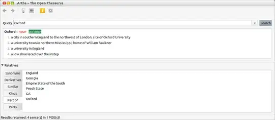

  • "Artha", A handy off-line thesaurus based on WordNet:
    Section - Universe/utils
    Installation:
    sudo apt-get install artha
    artha_snap

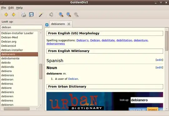

  • "GoldenDict", offering feature-rich dictionary lookup program using WebKit for an accurate articles' representation, complete with all formatting, colors, images and links.
    Installation:
    sudo apt-get install goldendict
    goldendict_snap

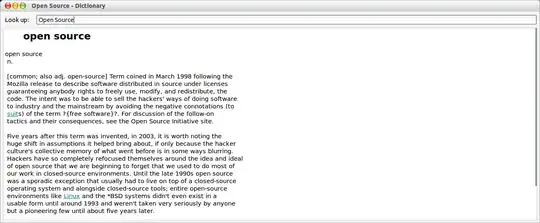

  • Gnome Dictionary:
    Section - Universe/gnome
    Installation:
    sudo apt-get install gnome-dictionary
    gnome-dictionary_snap
