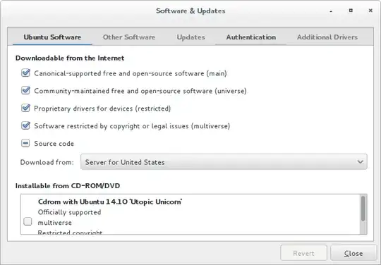

Luarocks is part of the universe repository - from the Dash, open Software & Updates, then in the Ubuntu tab, make sure the Universe repository is selected (see picture below). To install from the terminal, execute sudo apt-get update then sudo apt-get install luarocks, or install from the Ubuntu Software Center, by searching for luarocks

I'm not sure if you've updated your package index files lately, maybe some of the files you're looking for have been removed or renamed from the source, hence the "file not found" error. Try an sudo apt-get update first.
Or maybe the particular source (us.archive.ubuntu.com) doesn't have that file for some reason, if update doesn't work you could try switching to a different source/mirror? The Software & Updates program/settings can change those, and like Charles Green mentioned make sure you've got the universe checked. Those settings can also be changed directly in the files /etc/apt/sources.list and in /etc/apt/sources.list.d/ if you're feeling adventurous (though make a backup first just in case)
And when new to linux I preferred using Synaptic for searching & installing, easier than a terminal for looking through results with multiple windows & scrollbars imo.
