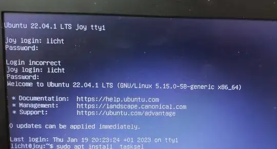

I accidentally switched from Ubuntu Desktop 22.04 to Ubuntu Server 22.04. Typing one command without realizing understanding it, I tried to switch to Ubuntu desktop by installing tasksel, but I couldn't update apt.
Ubuntu server image:
Ubuntu server image

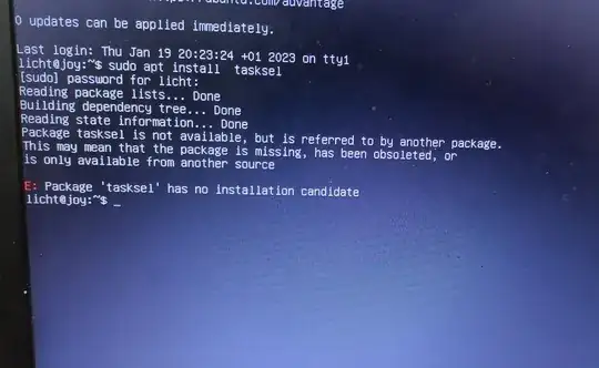

The error that i face installing tasksel:

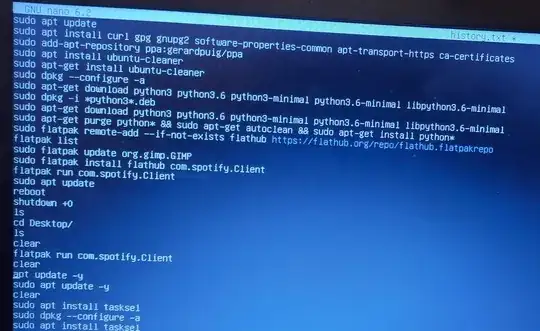

This is my terminal history after my laptop screen became red.
this is my terminal history after my laptop screen became red ...

To switch from Ubuntu Server to Ubuntu Desktop I had to install the ubuntu-desktop package.
That was not acceptable from my repositories.
This was the repositories problem. I added some released life repositories to:
/etc/apt/sources.list
All the links were like:
http://mr.old-releases.ubuntu.com/ubuntu
This resulted in the error :
mr.old-releases.ubuntu.com could not be resolved
I changed mr.old-releases to archive so that the link became like this:
http://archive.ubuntu.com/ubuntu
Then I updated apt:
sudo apt update
Then I installed the ubuntu-desktop package:
sudo apt install ubuntu-desktop
