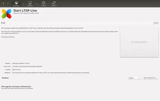

That said, If the content you want to share is on the Edubuntu Live CD, it might be simpler and easier to simply use This: LTSP Live
