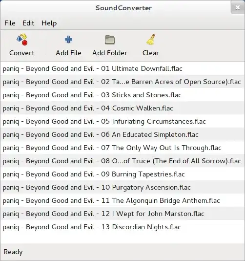

Graphical way:
If you prefer graphical tools to do this, I suggest you a small and simple tool to do so. It is soundconverter.
  1. Install it with this link → soundconverter Install soundconverter or using this command in terminal
    sudo apt-get install soundconverter
  2. Open it by searching in Dash with term "soundconverter". To bring Dash, Press Super key which is also known as Windows key.
  3. When it opened, Press the **Add File* button in it's toolbar, and select the file you want to convert.
  4. Then go to EditPreference from menu. In Type of result select mp3 and select a quality.
    • Very low = 64 kbps
    • Low = 96 kbps
    • Normal = 128 kbps
    • High = 192 kbps
    • Very high = 256 kbps.
    I think, you should select "Very low" or "Low" depending on your needs. Then click close.
  5. Click Convert button in toolbar to convert it.
That's it. Your file will be converted and stored in the same directory as the input file. You can also change the directory for output folder in Preference Window.

If you need a tool with a graphical user interface, then you can use Soundconverter. You can open the software-center and search for it or you install it manually via terminal.
Download / Install for Ubuntu
Soundconverter
