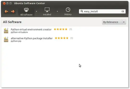

    1. Open Ubuntu Software Center and search for easy_install

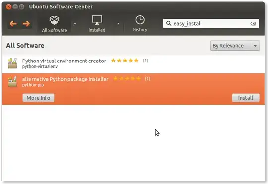

    2. Highlight alternative Python package installer (python-pip) from the list and click Install
