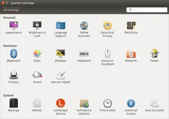

The GUI Method:
Assuming you're using Unity, click the gear in the top right and click "System Settings".
You should then be presented with this window: enter image description here

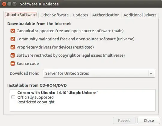

Then, in the bottom row, click "Software and Updates".
You'll then be presented with this window: enter image description here
Now, check/uncheck the sources that you want to enable/disable. You'll be asked for YOUR password on the first click.
