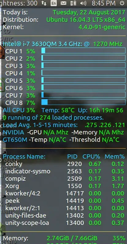

On my conky display notice how:
  • In the top section CPU utilization spikes from 3% to 100%
  • In the middle the temperature spikes from 60C to 80C
  • At the bottom memory spikes from normal 2.75 GiB to 6.25 GiB
Type stress --help for a full list of options.
