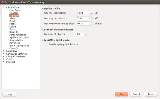

As pointed out by this comment you can increase RAM usage to reduce lag. 1. Launch LibreOffice. (The current version in the Ubuntu repositories is Version: 5.1.6.2 Build ID: 1:5.1.6~rc2-0ubuntu1~xenial3) 2. From the menu bar Select Tools->Options and then memory. 3.Increase the allowed memory for Libre Office and the amount of memory per object allowed. Example below:
LO-increase-RAM

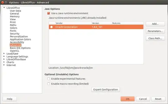

Another thing that you can do to help increase speed is to disable LibreOffice use of the Java Runtime Environment if you have it enabled. This is option is available under the advanced settings as shown below. Simply clear the checkbox:
disable JRE
