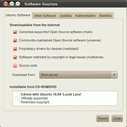

You can enable it in the grafical way, going to settings and then ubuntu software You will see something like this
enter image description here check them.
You can also enable then in command line. Press ctrl + alt + t and: sudo add-apt-repository "deb http://archive.ubuntu.com/ubuntu $(lsb_release -sc) main universe restricted multiverse"
