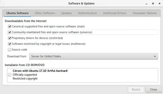

gfortran is located in the universe repository - please ensure that you have 'Community-maintained free and open-source software' selected in the "Software & Updates" program, as shown below.enter image description here
After adding this repository, you will need to let "Software & Updates" refresh the list of available packages.
From the terminal, enter the commands
sudo add-apt-repository universe
sudo apt update
sudo apt install gfortran
