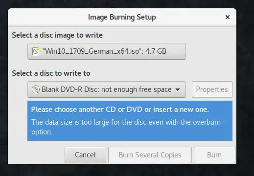

I have just downloaded a Windows10 image:
$ du --bytes Win10_1709_German_x64.iso
4710961152  Win10_1709_German_x64.iso
It is slightly too large to burn it to a dvd (4.7gb) with Brasero.
brasero dialog data size is too large for the disc
Is there a way to force burning the disc, using some additional space on the disc or shrinking the iso?

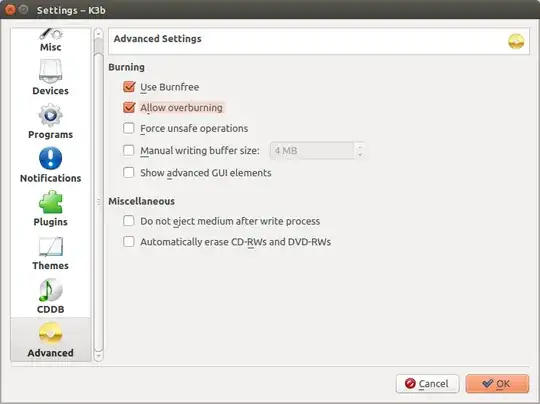

Use K3B as brasero doesn't appear to support overburn. Go to Settings->Advanced and check the allow overburn box as shown below:
k3b is available for all currently supported versions of Ubuntu in the Universe repository. To obtain it First enable Universe then issue the following commands in the terminal
sudo apt-get update
sudo apt-get install k3b
or use your favorite package manager.
