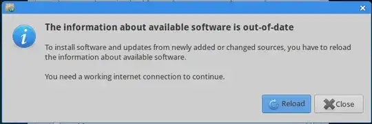

If it already was, then most likely I have guessed wrong about the cause of your problem. If it was not already checked, check the box (you may need to enter your password) and click Close. You'll be told "The information about available software is out of date"; click the Reload button.
Then try installing g++ again.

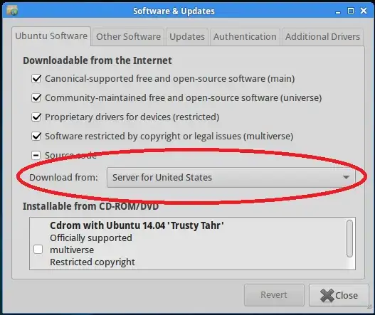

Try a different APT mirror.
If the main component was already enabled, maybe there's something wrong with the APT mirror you're using. Especially if you're not using one of the official mirrors (us.archive.ubuntu.com, with us replaced with your "country code"), I recommend trying a different mirror, an official one if possible.
You can set your APT mirror in Software & Updates as well. Just change it in the drop-down menu labeled "Download from".
As when enabling a software source, when you quit Software & Updates after changing your download server, you'll be prompted that software information is out of date and you should click Reload. Then see if g++ can be installed.
