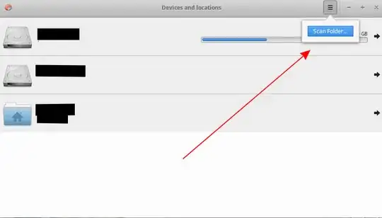

You said "..baobab just keeps scanning endlessly without counting any data when I ask it to just scan my home directory..." so you might have already tried this, but for others with this problem; I found that while selecting the root directory just showed me a bunch of ambiguous ENCRYPTFS files, selecting my home directory from the "Devices and Locations" screen solved this problem.
On the first "Devices and locations" screen, click the three line icon in the upper right, and hit "Scan Folder..." in the menu that pops up (picture of the menu) Select your home folder, and baobab should scan it.
Note that I only tested this while logged in to my account, and that it took a very long time (1hr+ for 220GB) which might account for your "endless scanning".
