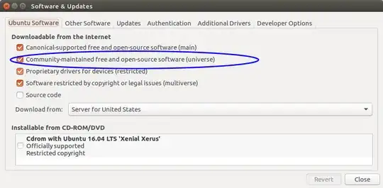

Gnome-twitch is available in the Ubuntu Universe repository. To make sure the Universe repository is enabled, Open Software & Update app and mark the check box next to universe.
See How do I enable the "Universe" repository?

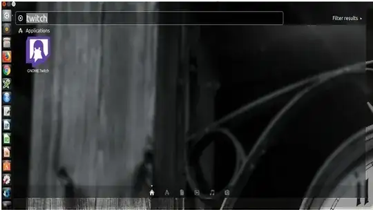

To start gnome-twitch search for it in the Dash and click on it:
