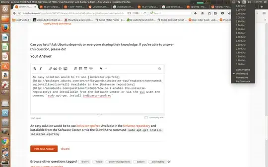

An easy solution would be to use indicator-cpufreq Available in the Universe repository and installable from the Software Center or via the CLI with the command sudo apt-get install indicator-cpufreq With it you can choose between performance and power savings or even fine tune the clock rate (depending on your configuration as seen below.
If you are having issues with your system forcing turbo on you can flip the swich that allows this behavior with the command echo 0>/sys/devices/system/cpu/cpufreq/boost to disallow frequency boosting and echo 1>/sys/devices/system/cpu/cpufreq/boost to allow it. Disallowing boost will have an impact on both heat and performance.

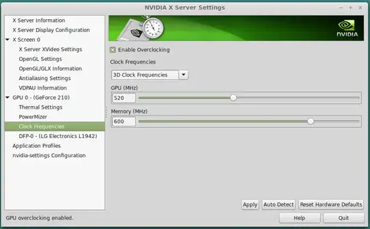

It would also be prudent to check nvidia-settings and make sure overclocking is disabled Under Clock Frequencies by removing the checkmark in the box seen below:
NVXS-sets-ovrclock
If for asome reson you can't find the Clock Frequencies Setting examinine the Thermal Settings and Power Mizer settings to insure that they are sane.
