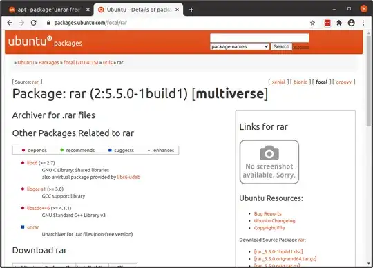

Let's review how to find packages in the Ubuntu repositories.
First, let's look for rar using the packages.ubuntu.com website. The web page for rar shows that the rar package does exist in the Ubuntu repositories, it's available for 20.04, and it's in the "multiverse" pocket:
packages.ubuntu.com

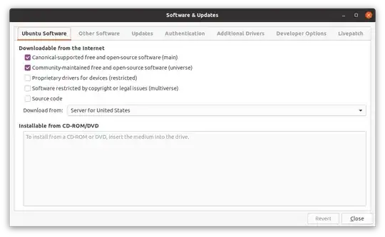

Next, let's look for "multiverse" in the Software & Updates control panel. In my example below, you can see the "multiverse" is unchecked. Check it.
Software and Updates
  • You can find Software & Updates using your normal Desktop Search.
Finally, run sudo apt update because your sources changed.
Now rar and unrar will be installable for you.
unrar-free is slightly different. It's in "universe" instead of "multiverse". The process is the same; merely a different checkbox.
